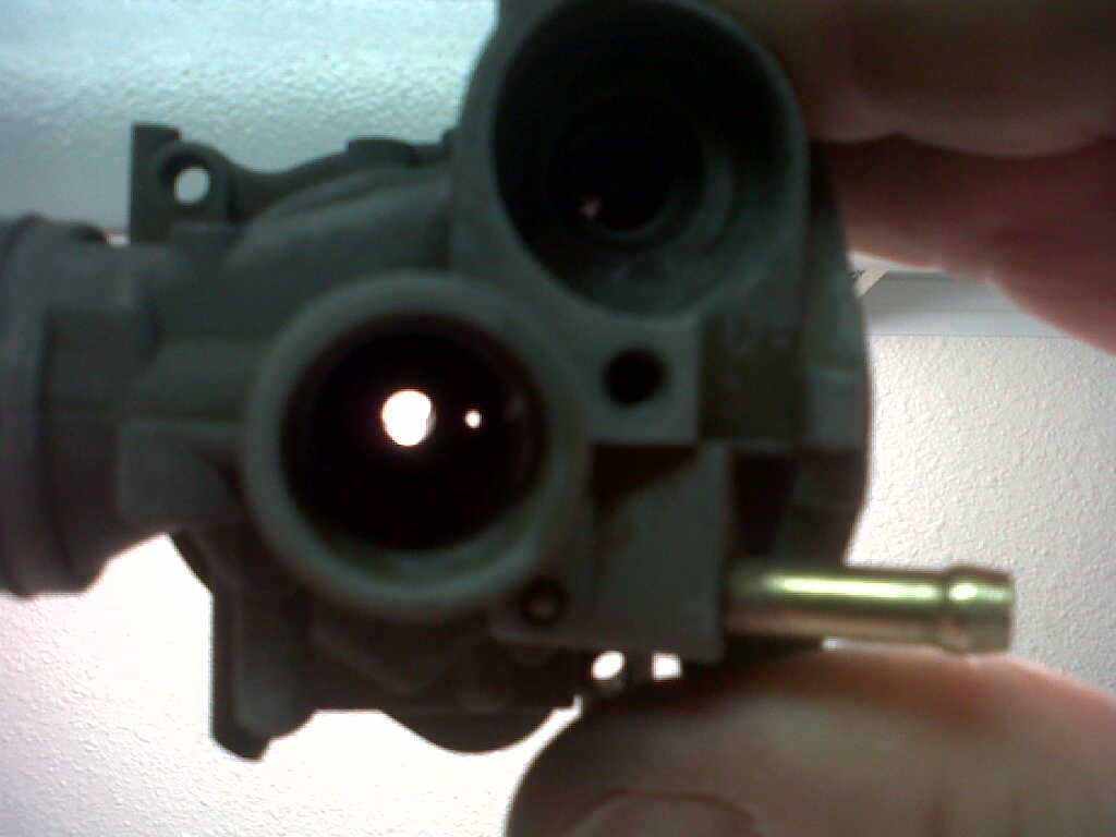

Plug is new and looks normal after operation. Pin is in middle slide. Carb is set to specs. I'm convinced my carb is not completely clean since my Spree is running significantly better without the auto bystarter plugged in.
After seeing the attached photo in viewtopic.php?f=5&t=21448 I now know that I didn't clean my carb as well as it needed to be. I tried clearing out the cast pilot circuit hole with a guitar string prior to reassembly but after 20 minutes of no success, I was convinced that it wasn't designed to go straight through - and obviously I was wrong. It would be great if the attached photo from viewtopic.php?f=5&t=21448 was added to all photo collections of carb cleaning procedures.
I will report back once I get the pilot circuit hole clean and I am able to determine is this was my issue.

- File showing small cast pilot circuit hole courtesy of Wheelman-111
http://hondaspree.net/phpBB3/viewtopic.php?f=5&t=21448 - WheelmanSpreePinhole.jpg (39.06 KiB) Viewed 5786 times

Three days of soaking in Berryman's and my pilot circuit will not blow clean. I'm frustrated to say the least. Does anyone know where I might be able to score a new and/or used carb body? I think I have to give up on mine. I'm trying to source one locally in Phoenix through salvage yards and Craigslist but I'm not having any luck. Am I making too big of a deal over this pilot circuit? Should my Spree be running OK with this passage clogged? What does it do anyway?
