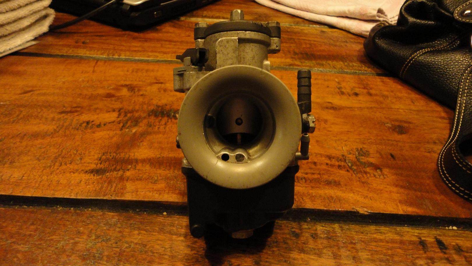

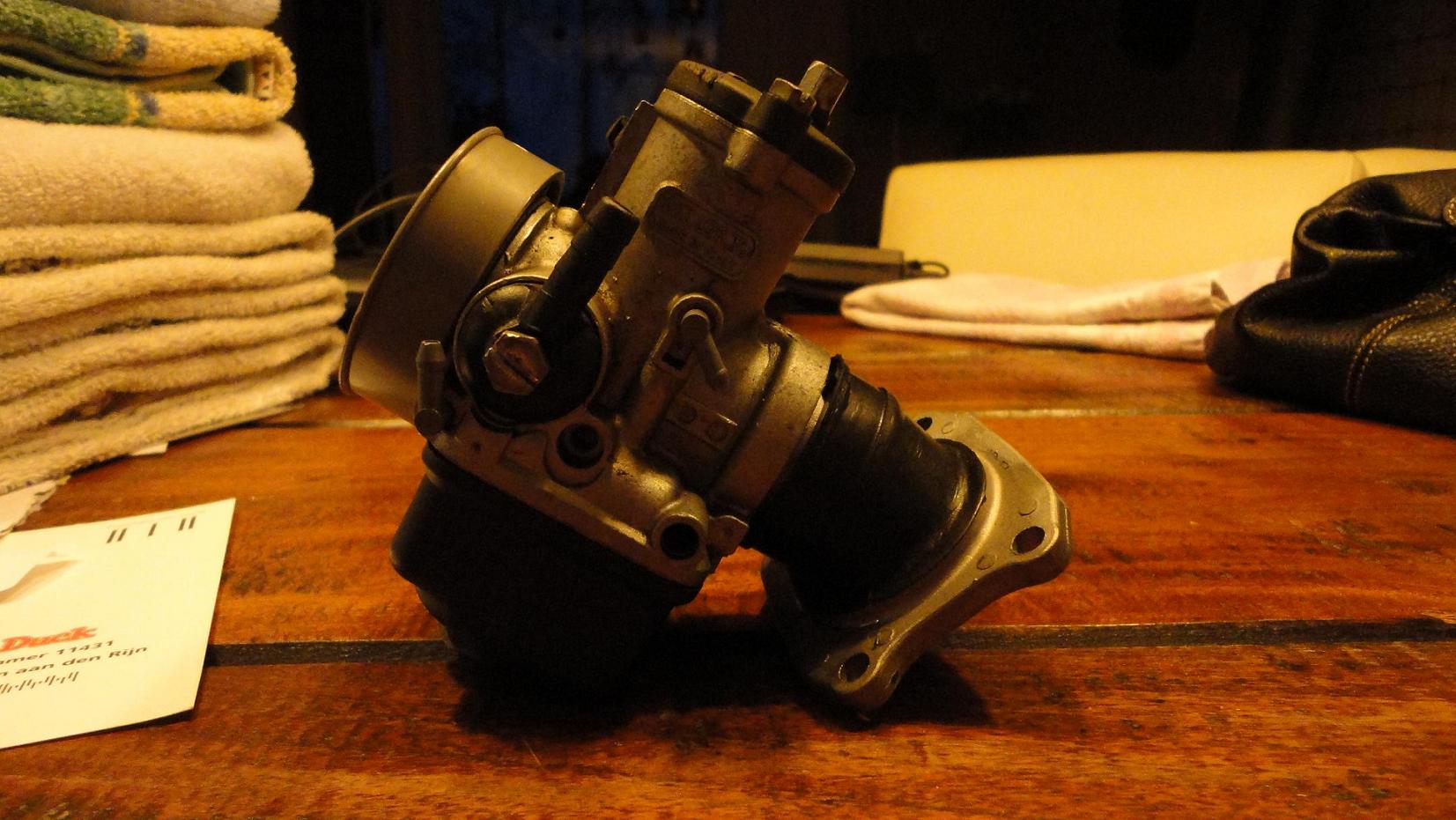

Re: 125cc stroker project :D
Well I have a nice intake manifold now!
It is an original Honda CR85 manifold!
My carb fits perfectly!
Koert
Koert
Does that setup use the stock reeds?
Why not just use the ct manifold and the bigger reed cage?
I am afraid that the stock reed cage will restrict your 125cc setup.
I will be using the CR85 reedcage.
And I don't think that the CR85 reeds will restrict it at all
Why I don't use a CT manifold: I have to have it shipped from the other side of the ocean
And I am a verry impatient person!
Koert
Koert
