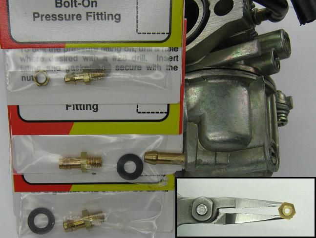

Quick trip to the hobby store landed a set of the DuBro pressure fittings. From top to bottom we have 6-32, 8-32 and 10-32 all priced @ $1.90 ea. Compare the barb to the carb bowl drain (Edit: carb bowl drain barb for size reference), and pick your size. Note on the inset photo, these fittings are just straight through threaded barbs - no check valve.
Bear45-70 wrote:You pressurize gas tanks with crankcase pressure not exhaust gases. Pressurized gas tanks are not new, the outboard motor industry did it back in the...
I don't know why - but muffler pressure still gets used in the hobby world. Folks used crankcase pressurized fuel systems in model engines decades ago too. Here's a link showing a muffler pressurized fuel system in an RC car.

Z50R_Blank have both been searching for those. Uhh, Whut's a "Hobby Store?" Any National chains with parts like barbs online? The ones Z had looked like they were made for our carbs, even a tiny O-ring seal under the barb.

Back up there :lol: - I mentioned the type of hobby shop (RC models) and put in online link earlier in the thread we are in. In the post you reference, I was trying to help the online shopping guys select the size they wanted. Also to show the fitting is a straight through barb - no internal check valve.

So one of the above mentioned (and shown fittings), a drill and tap, and I can run oil and petcock on my intake correct?
Re: Aftermarket Intake Mani and fuel petcock
Posted: Tue Apr 13, 2010 9:36 am
Yes - drill/tap, thread sealant/locker is a good idea. As Wheelman said early in the thread, separate tap for oil & vacuum.

Just got back from my lunch break and a reasonably short drive to my "local" hobby store (12 miles and across State lines, but hey what we wont do for our scoots right). They only had one fitting in stock that Mr. Mouse posted about above, but I now own one 6-32 Du-Bro fitting just like shown above. They guy at the store was nice we chatted for a while about what I was doing and when I said that was all I needed he said just give me $1 and call it good. Not that the $0.90 savings is that much as compaired to Mousewheels, but a nice guy none the less.
This adventure out also swung me close enough to go slightly out of my way to my local Honda-san. Picked up a couple more bottles of oil, and they happened to have cone-o-stone fuel filters as well so I picked up a few to have on hand.
Now I have to try and find 6-32 tap... I am certain my tap set doesn't go that small.

Is the barb 1/8" outer diameter? You don't want any looseness on the vac line - or oil, for that matter.

The outside of the barb portion is closer to 3/16, the smaller tube portion is 1/8

Check out the tubing fit. If a bigger one looks better, pm me and I'll mail it out tonight, least we can do after that flywheel puller detour.
Went looking for specs on the DuBro fitting, but their online catalog provides none. The part numbers may be helpful. Found a right angle fitting with a washer (probably still not the one Wheelman's looking for). They give no size, other than its a 4mm thread. Visually, the barb is approx in the correct range - if I recall, the oil line is 3.5mm.
