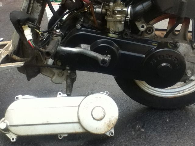

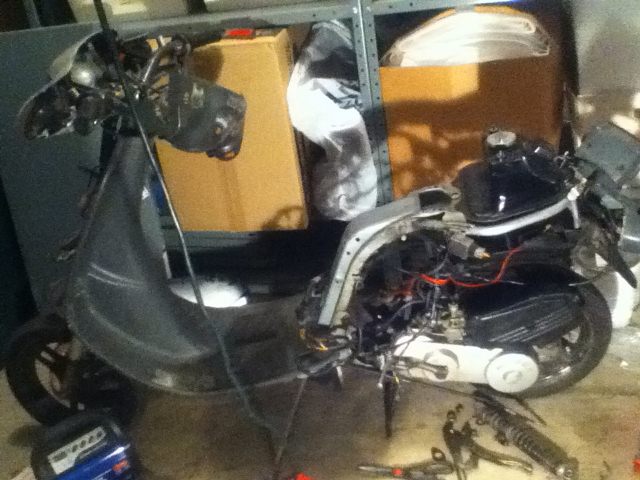

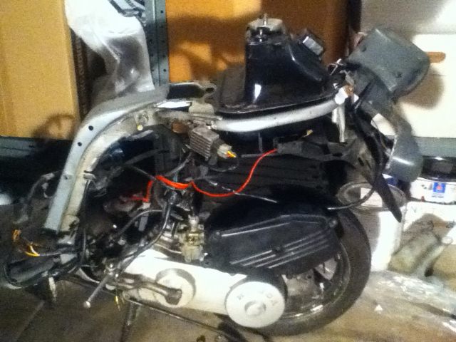

Ok Some of you might have seen me posting that junk moped on there for sale and parts. Today I've starting to take it apart so I can post the parts on Ebay. Then I change my mind and tell myself I have to get you running. I took the engines of complete. What I found are . There was no cylinder Gasket on there , no rings on the piston, and no cylinder head gasket. I replace those missing parts. Used my old carb from my honda elite SA50P. After spenting couple hours putting the engines back together. I put some gas in the tank . Try kick starting and that thing just took off like a "JET" I forget to put it on stand when I was kick starting it .I was so happy . All It need now is a new battery,those panels,new tires and a muffler. My muffler have some big holes and that make it so loud .
NOW I HAVE THREE IN MY GARAGE .I THINK I AM GETTING ADDICTED
Also cheapcycleparts.com is really slow with shipping. I have oder couple parts for my elite SA50P since Friday and I am still haven't receive anything.

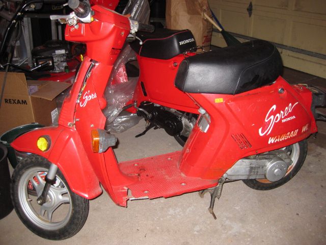

Post by Duke250 »
I JUST PICK UP 2 HONDA SPREE TODAY FOR $149. THE RED ONE HAVE 2384MILES IN IT AND THE BLACK ONE HAVE 1899 MILES IN IT.

Post by Duke250 »

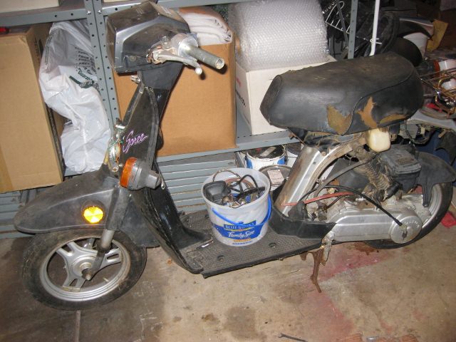

YEP GOT SOME WORK TO DO
