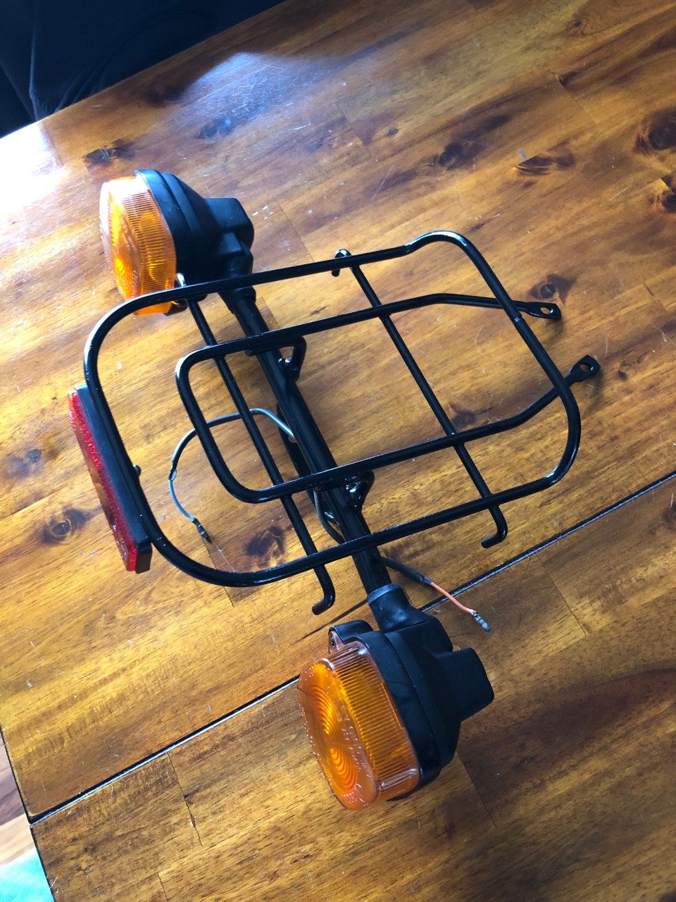

Made a shorty blinker rack

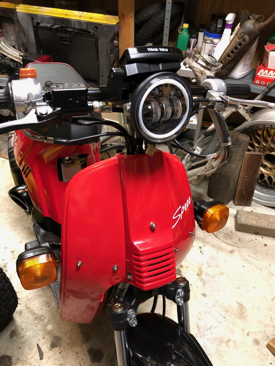

Making a bracket to mount the headlight, I ended up buying a motorcycle fog lamp that was 4-1/2" dia. Outside ring will be the low beam and LED's will be the high beam.

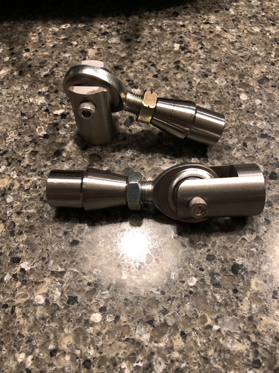

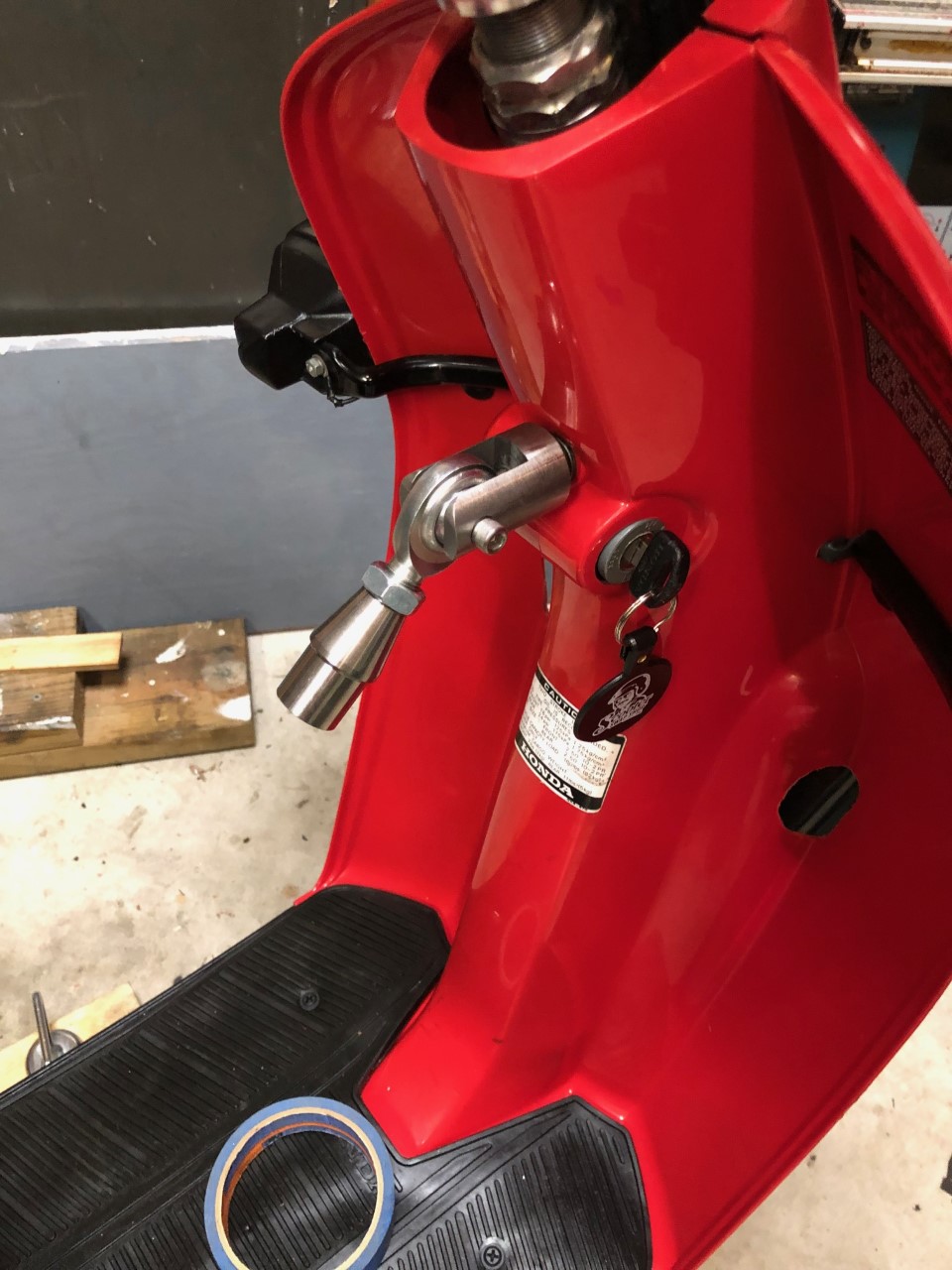

Machined up some mounts for the frame support. Once I get them fitted to the bike I am going to weld a tube between the two. One if a right hand thread and the other is left hand so you can adjust the length.

Frame support mounted, headlight mounted and headlight bracket mounted,
