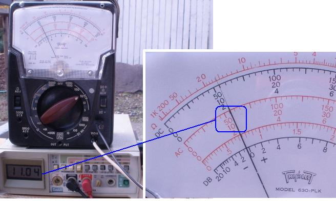

When measured from the yellow and white wire connectors coming from the alternator, the numbers are the same. Here's a picture of that wiring; I dunno if it's all stock. A previous owner may have done some futzing with the electrics, I don't know.
https://www.msu.edu/~steine13/toeff01.jpg
For reference, I measured ground to ground to see what "0" would come out to, and got numbers from 0.1 Ohm to 0.6 Ohm, depending on where I put the test points and how hard I pushed. From those measurements, I'd say regulator/rectifier and charging/lamp coil check out. But that doesn't change the fact it doesn't work...
I also looked for loose wires, but the only thing I could find that was wrong was the 7A fuse that should be on the red wire coming from the battery was missing and the wires were twisted together and taped. I used a clip lead to bridge that.
https://www.msu.edu/~steine13/toeff03.jpg

I've been wondering about the scope waveforms shown in the prior links. There were some large peaks, which mightconfound some meters. Today, took out an old school VOM and the Fluke true RMS meter. For the stator output of the '86 Gyro, the two meters tracked well. Idle was around 9.5v with a dim light, full throttle around 12.8 VAC.
Photo shows reading of about 11v. It is at much less than full throttle - maybe 1/3 or so... Hard to juggle the throttle, balance the bike and take a pic
- TrueRMS_Vs_Multimeter.JPG (39.54 KiB) Viewed 5550 times
