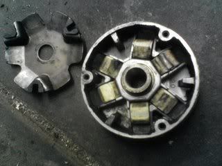

first off, what in the world is this? and is this how it goes together (it fell out and scattered, so i just placed them where i thought they went)
my guess is it is some sort of cintrifugal clutch for the belt? but either way the little plastic peices all have flat spots in them, and one is split all the way to the metal.

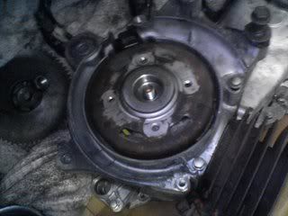

also, does this require a special tool to get off? the guy i work for said its a common motorcycle tool and it threads in and then pushes on the crank. sounds right, but is there any way to get around it?

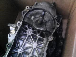

and inside this back case is where the gears that i will be buying go right? I couldnt get it off, i took out all 5 bolts and it still wouldnt come off. i didnt want to pry it incase i was doing something wrong.
to your first question, that is a variator, . the things inside it are called rollers. When the motor revs up the rollers go out, pushing the back plate out. Making the hole thing move. the belt now rides higher on it giving you good top end.
Rollers are something you need. Flat Spots will cause really bad take off.

third question. Mine came off easy, but i know sometimes its hard to beak the sell. Just fight it some.
I would just work on the plate and not fight the axle.

okay so the rollers need to be replaced.
all the stuff i need (rollers, crank bearings, gaskets, ect) can be gotten from the Honda dealer? like the car honda dealer or does it have to be a moped/atv/bike dealer?

i will work on the case tomorrow. But that is where the gears go right?

second question: Come on! i need that answer lol. how did you get yours off? that is all thats left from me getting the crank/rod out and im ancious!:D

You will prob need a puller, something like this. http://store.chromeauto.com/at3041.html
