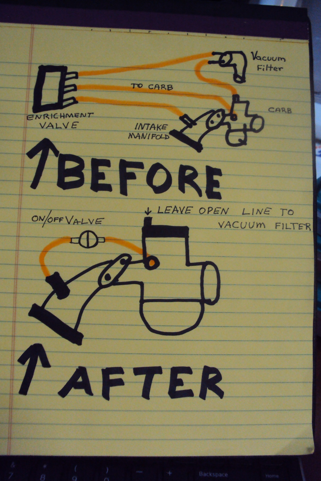

Hey Mr. Rob406: Here's a notion. What if you retain your OEM carburetor,
and instead of replacing it, eliminate the octopus choke system ?
I've found that by eliminating the original cold-start system can be easily done
with some new fuel line and a simple inline fuel shut-off valve.
While i don't have personal experience with the Aero 80 specifically,
I have copied the method of converting the auto-choke to manual choke on the Honda Urban Express.
It seems the two models share that system of a bi-metal valve control.
I will include a crude drawing I made for the Urban Express.
Maybe you can get the idea of using the fuel shut-off valve as the choke OFF/ON valve.
Your access to the new valve will be limited due to your covers, so you will need to
route the new system for easy access.
You can also try the search feature for this page to research the posts that discuss the Aero 80 choke system
and the details of just how it was eliminated by the member Bear 45/70.
Hang around for more replies from member Breaze who has experience with your Aero 80, good luck sir...motor

- choke elimination.jpg (495.3 KiB) Viewed 31890 times

Thanks for the reply! Well i actually pulled the trigger on a 21mm carb, intake and some other goodies. Knowing how hard it is to find parts I have kept all original pieces labelled and packaged neatly.motormike wrote: Mon Sep 11, 2023 1:45 pm Hey Mr. Rob406: Here's a notion. What if you retain your OEM carburetor,

Oh and I got rid of the goofy choke system on the stock carb years before I upgraded the carb to a 21mm PVK model. It's spmewhere in here on what I did.
