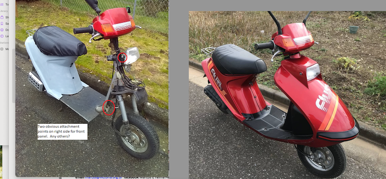

I see only the attachment points where circled and compare to a file photo.

Post by DavidB »
I see. Where I circled, low are two 6mmx1mm threaded holes for the inner panel and floor board that starts curving up. I might attach a horizontal piece of wood to it for the kick panel that is black. The upper part of the black panel would attach just to the left of the ignition switch. By building the black inner panel properly, the outer panel can attach to it. Using steel, I'll need to think through the attachment method. The outer would also connect to the head light bolts.

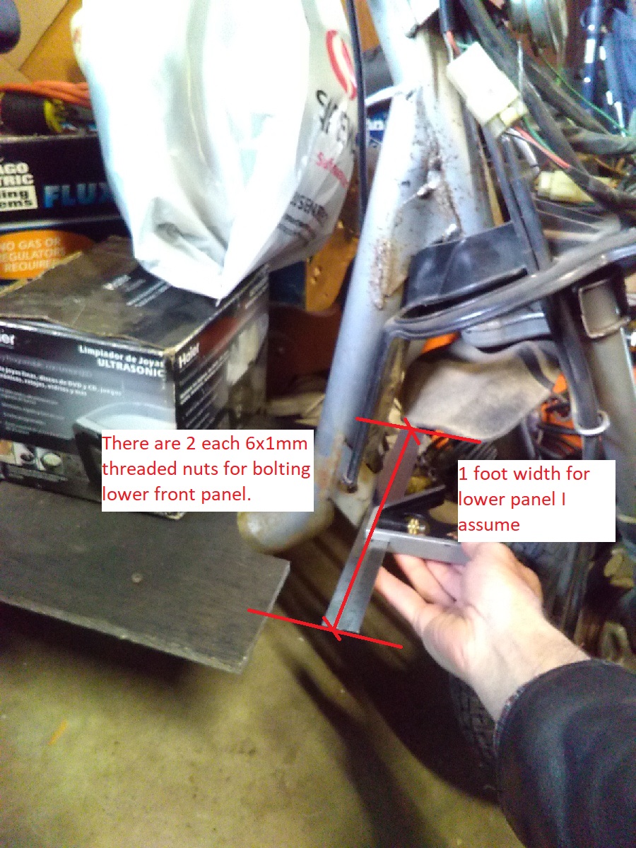

It looks like only 12" width to work with to extend the floor board and build the front panel.

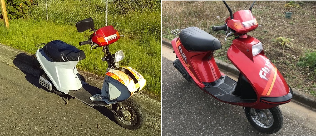

I have a question: How wide is the floorboard and front portion below the handle bars on the stateside Sprees? Mine is 13 inches as I compare to a stock photo, width unknown. Thanks.
