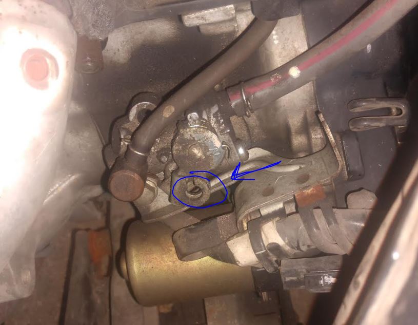

From what I'm seeing, am I correct in assuming there shouldn't be anything attached to the oil pump here? Sounds like there would be a cable attached on the unrestricted models?
