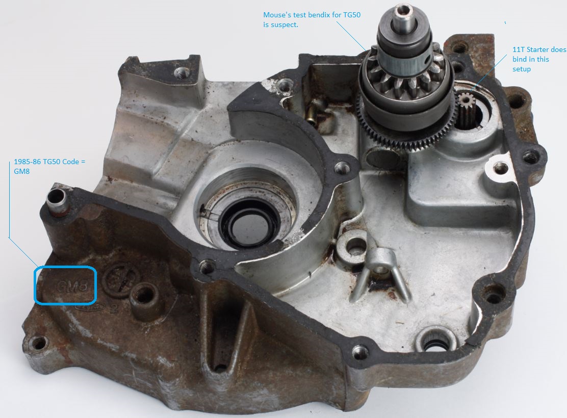

- Posts: 3487
Re: 1985 Honda Gyro starter issues
There's one part of 'identical' digging into. What is the tooth count on your Gyro starter? The OEM starter's I have for NN50 and TG50 Gyro's are 10 teeth.harleyracer59 wrote:I have t torn into the aero starter but you can see they’re identical.

- Posts: 3487
harleyracer59 wrote:that's awesome about the twisting the can to switch direction.
Thanks for the 11T clarificationharleyracer59 wrote:however youre half right on the starters. one is 10 tooth the other is 11. you cant swap starters between nn and tg. I believe the 84 nn50 is the oddball 10 tooth and the 85-86 tg50 is the common 11 tooth. I could have it swapped around though. I cant remember
Years ago I did mock up a TG50 case side, Bendix and 11T starter. I still have the Bendix in a bag and repeated the mock up last night. It still binds. I'd conclude the Bendix I used for fit testing is not the correct part.
- harleyracer59
- Posts: 258
- Location: Nickastan ca
that's probably a tg starter and a nn Bendix. when I tried the 10tooth nn50 starter on a tg Bendix it made a god awful screeching noise
