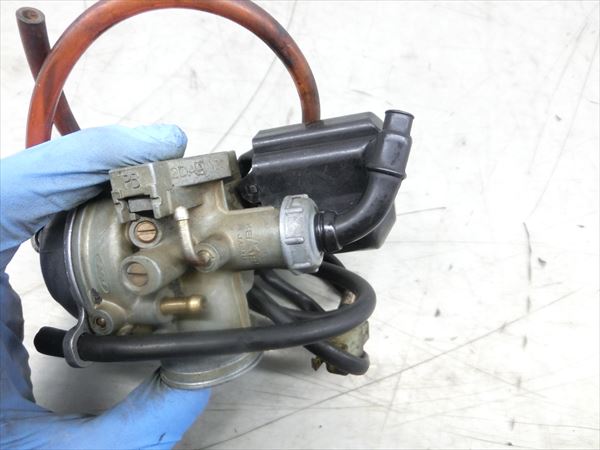

So what year is it by the way? Did you try to find the model designation on the flange of the carburetor?
Keihin PB.jpg (34.9 KiB) Viewed 30284 times
bonesv
Posts: 1616
Re: Aero NH80 Float filling with gas
Post by bonesv »
My thinking is that the newer model of that same carburetor which is used in various Asian/European models has the adjustable float and new float needle. I used the adjustable float and float needle in my 1985 PB carb and it worked fine. Be sure you measure the float distance to specs to insure proper operation.
