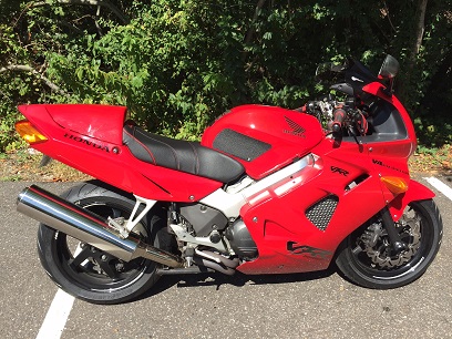

Quite a contrast to my recent Dyna coil sticker shock! I've been quite fortunate with my '86 Spree....other than tires , fresh fuel purges and occasional carb cleans..its been issue free since purchase used in the mid-90's. It does do its fair share of sitting, though. I've got another Honda I can ride, too : )

As a matter of fact, I just ordered one....very reasonable. I got the Spree for $200 and have spent about $90 on ordering things so far and when it all gets here I should have most everything I need to get it up and running. The Ducati is beautiful.

^ a very reasonable "buy-in" on your scoot.
Not my Duc... thats my 5th Generation '98 Honda VFR800 pictured (very special gear driven camshafts)
