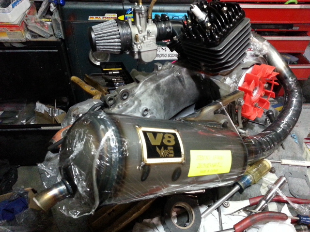

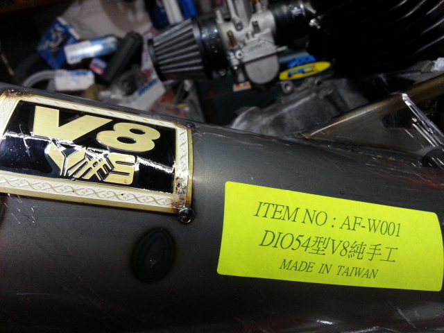

Forum this V8 pipe is made for the 54mm.
