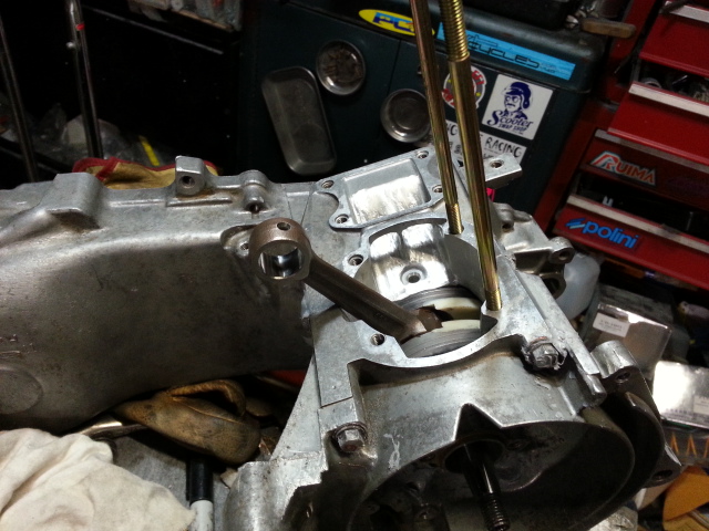

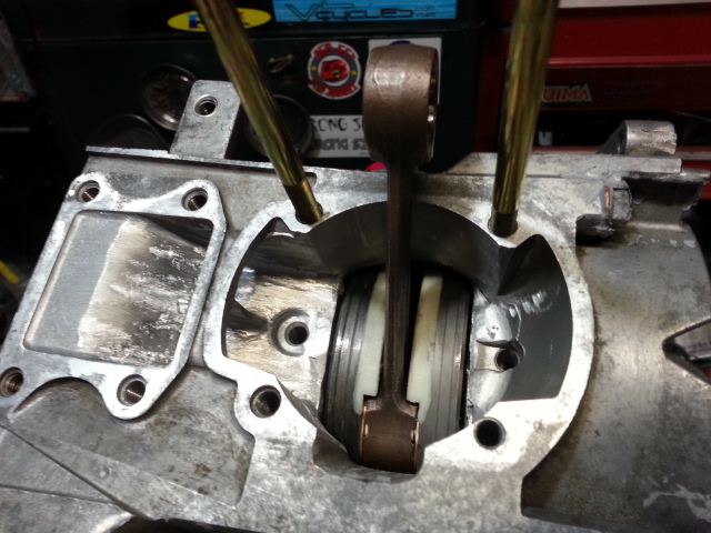

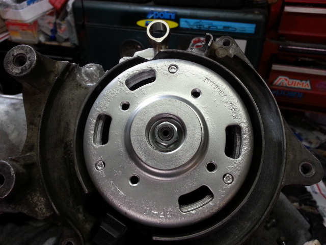

there are special "slim" crankshaft bearings that are used with this crank.
if you use the stock bearings the case will not close and seal together.
i have slim bearings for sale if you need a set.
lmk
btw nice build very meticulous very nice

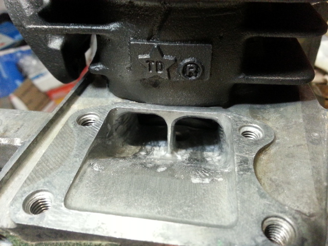

ped wrote::coolcruise:
Where did you get that cutting tool?

HI808SYM wrote:there are special "slim" crankshaft bearings that are used with this crank.
lmk
Thanks. The Kit came with the bearings. :thumbwink:
ped
Posts: 1598
Location: northeast usa
Re: 54mm / nuts packed in box
Post by ped »

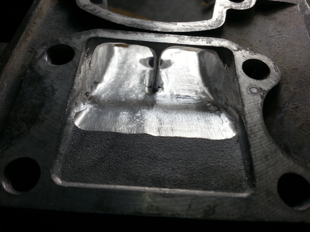

http://www.ebay.com/itm/Honda-Dio-Elite ... SwSlBYucVt
Hi, I bought the tool on eBay. It's very hard to work with this tool. You have to take off very light cuts. You also have to use a Dremel to finish. There is some skill involved. I recommend a machine shop. The tolerance are too close and easy to screw up. Also it's not easy to cut the top of case for the Big Bore cylinder. Good luck :coolcruise:
