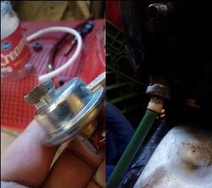

fuel petcock rigging question I didn't do this.
Please tell me that I don't have one of you guys to thank for this...
Previous owner jb welded the petcock sans any mechanical attachment to the spout on the tank.
I've found a n.o.s. petcock local for $15 so no problem there,
I'm just wondering if (I highly doubt it) someone here may have advised him on this little piece of McGuyver.
He also drilled 3 5/8 inch holes in the airbox lid,
And then just draped a wash rag over the airbox for a filter,
Then since it was running extremely lean he drilled out the jet, or removed it altogether...
Which I was trying to find out when the jbweld let go and started draining the tank all over my kitchen.
I jammed the colored pencil in there to stop the blood loss until I can remove the tank.
Now, on to cleanup!
Now, on to cleanup!

I highly doubt anyone here recommended the JB weld, drilling the pilot OR the rag filter. That sort of shade-tree nonsense would get blasted by endless ridicule on this forum.
Myself, Ive seen some pretty funny things when digging into newly acquired scoots. I once opened a Spree airbox to find the previous owner had installed a yellow kitchen sponge as a filter. Nothing surprises me with these things...not even SpongeBob FilterPants.
EDIT: Drilling jets CAN be done successfully by someone who knows what theyre doing. This guy obviously did not.

Okay got the carb apart, The main has NOT been drilled (yay!)
The jb, or lead substitute, something grey and clay/plastic looking got into the tank, AND blocked up the sending unit.
Tore it apart, and cleaned the crap out of it (literally), It actually works now (Yay again!) and still need that petcock...

The main jet was removed and was sitting in the bowl of the carb...plugged completely.
Is it safe to run through the passages with nylon?
Like a piece of fishing line.
I figure there can't be any way that the metal (brass, or copper) the jet is made of could be softer than monofilament line.
Again advice is greatly appreciated.
