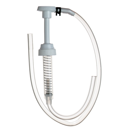

Basically you just fill it through the drain hole until its full and starts spewing out. I let the extra dribble out before I put the bolt in so its not over filled. After the first few pumps I spin the tire by hand to make sure its where it should be, then continue filling.
Myself, I use a pump as pictured below. They can be had for $5-$10 pretty much anywhere. I get mine from Walmart in the boat/marine section. The supplied hose doesn't fit into the fill hole so I attached a small 3" piece of vac hose (drinking straw works too) to the end, works great.
I cant remember if it was Wheelman or PatTheSoundGuy who once posted as using a Ketchup/Mustard bottle with a pointy tip purchased from the Dollar Store. Just shove the tip in and squirt! :naughty:

:lol: I'll try that! I've always tried to use a funnel, but that just isn't working anymore, by the time I'm done I have half the oil on the ground :|
Re: Spree Transmission Rebuild Kit?
Funnel schmunnel.
You can buy a 50cc syringe at the Dollar store,. Measures and injects precisely.
