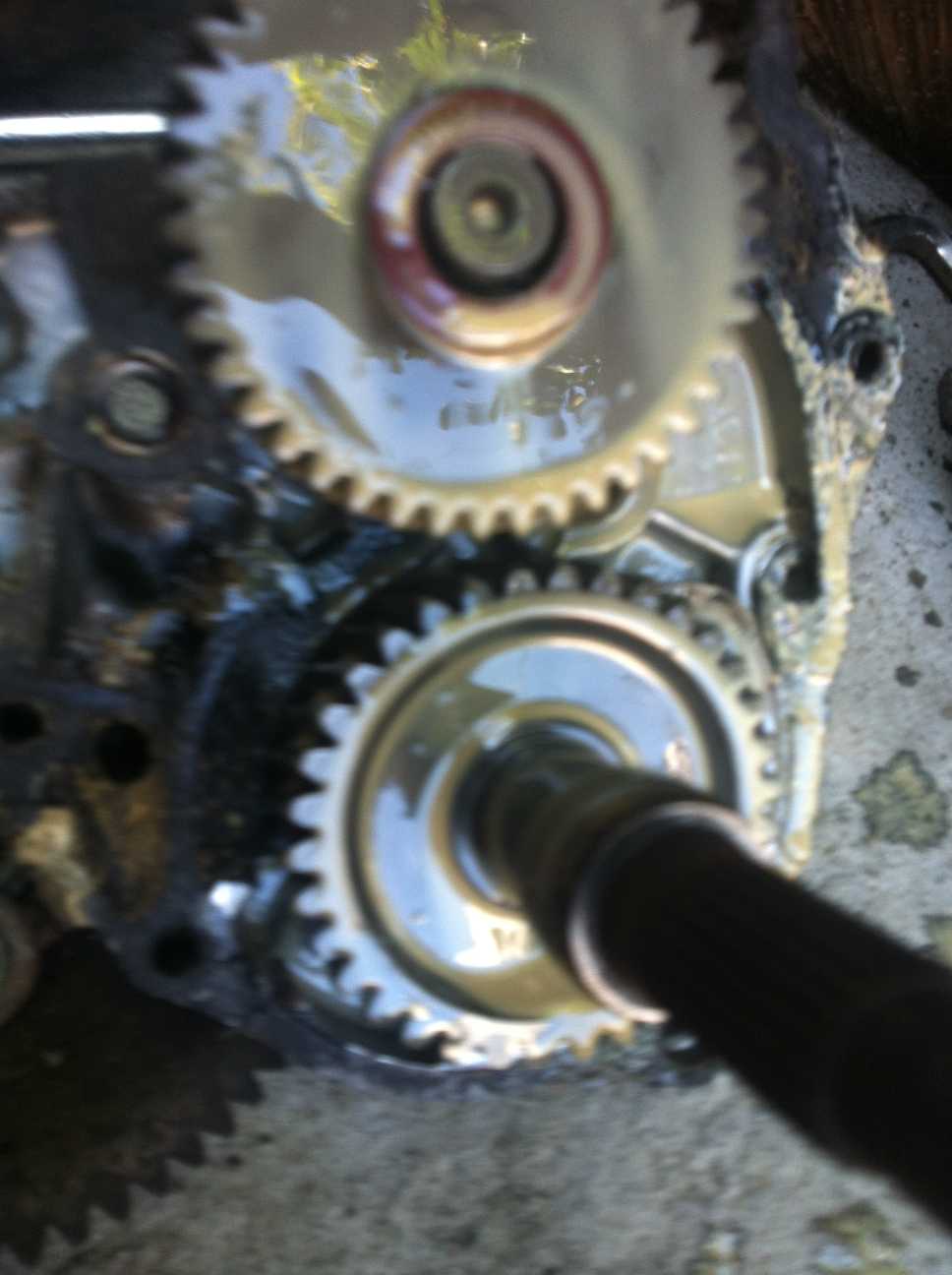

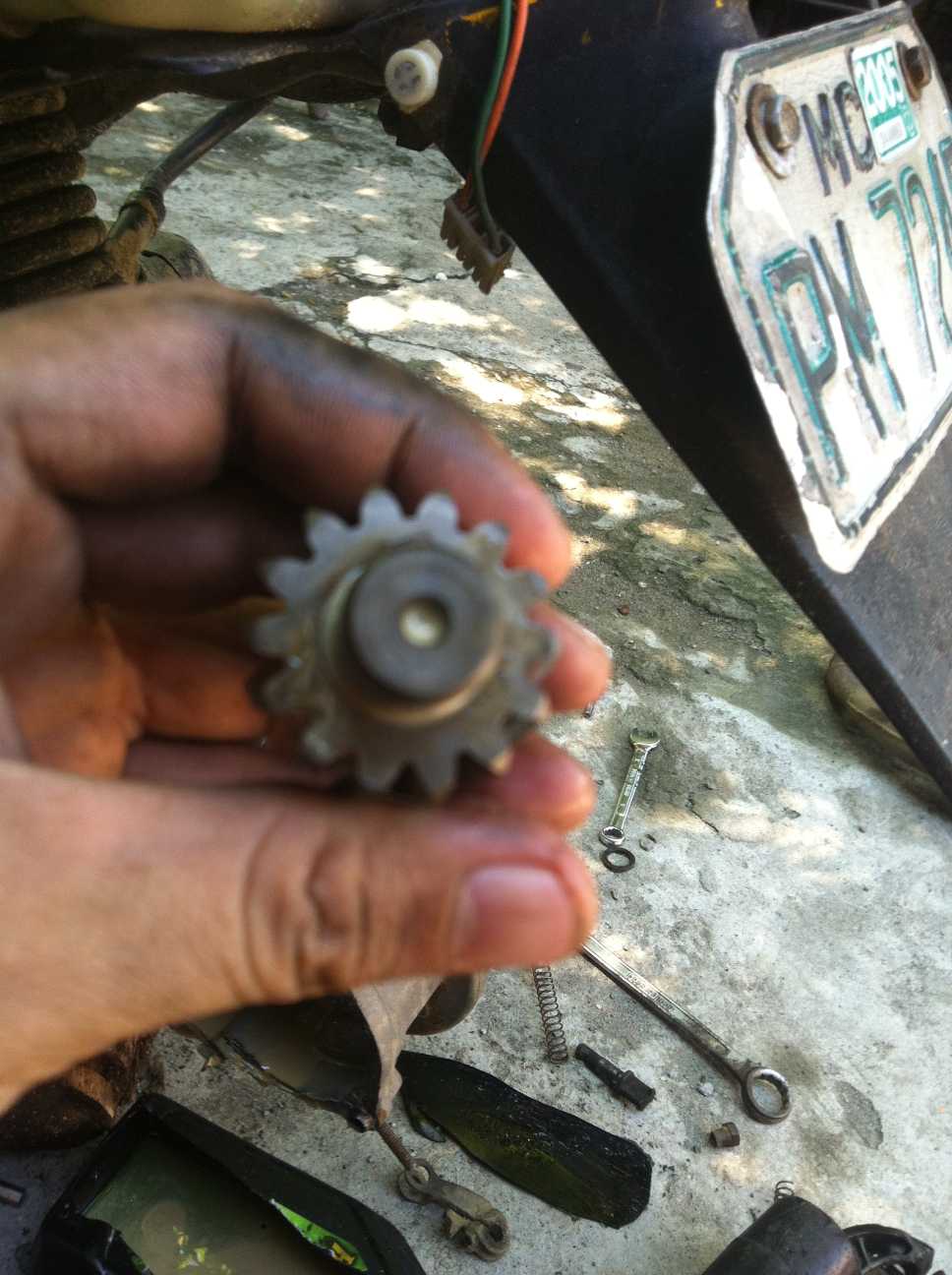

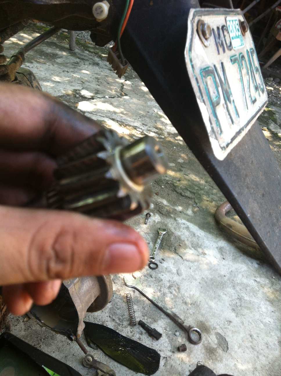

or if you can find a 14x34 gear it wont hurt ur acceleration i can still pop a wheelie with a decent tops of 80kph primary gear is on 12x42 658 dio 3 belt overrange torque drive stock clutch 1krpm clutch 1.5krpm center. here is the image of the 14x34 gear.
- 031.JPG (109.41 KiB) Viewed 14846 times
- 032.JPG (65.55 KiB) Viewed 14846 times
- 029.JPG (104.85 KiB) Viewed 14846 times
