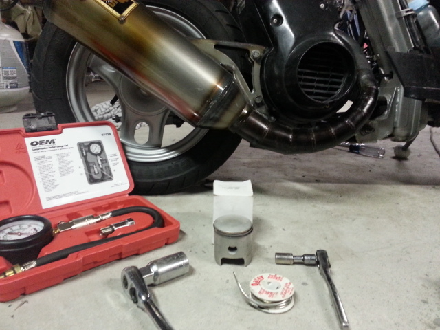

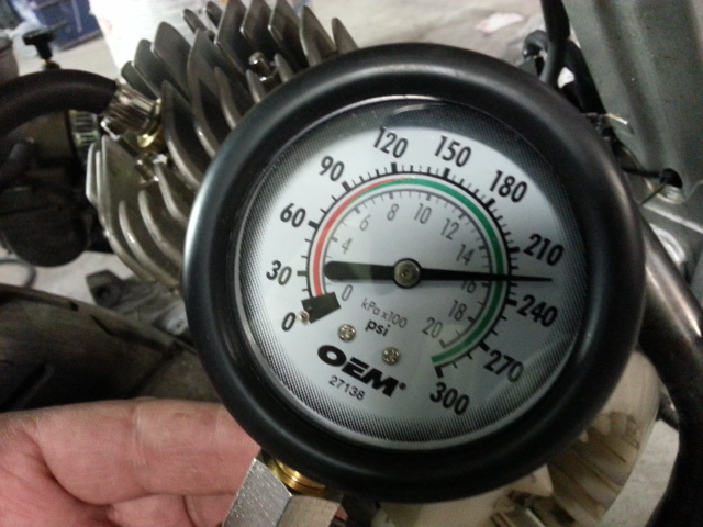

I have a motor noise on 50mm. :surprise: i don't know if it's piston slap or what? noise is like a tick. :x please check video noise starts at 14 sec.
https://www.youtube.com/watch?v=aRiS1CbVTmE
The compression is around 220psi. I'm also using 100 octane racing fuel. Squish it is at 1.2
I did remove the head to check the piston and the bore everything looks good. No dents or scratches. Motor has about 150 miles.
The motor runs great, and has power. 65+mph.
any advice would be greatly appreciated. :thumbwink:
Re: 50x50 98cc stroker build
Yikes!! That works out to 15:1 compression ratio. This is in Diesel territory (14 to 22:1). Unlike Herr Diesel's engines however, the top-end bearing may not be up to the task of supporting that level of compression for very long. I'd suspect a little slop has developed in the little end, maybe the crank end as well. This can be checked and compared to FSM specs.

Post by ped »
Thanks Wheelman.
I did a search before posting and came up with ring wear, piston slap. all were associated with high mileage . I'm still confused because I have low miles.
I took it apart and everything looks good. Everything seems very tight.
My best guess would be Rings did not seat properly?
I'll take care of that compression right away.
When all else fails use a repair manual. :lol: thanks Wheelman. I need to know those specs :smile:

Thank you Mr G. Definitely changing out the piston and rings.
I believe, I didn't do the "important" proper heat cycling and breakin. :sad:
It's not good to be in a rush. to see how fast it will go. Proper braking will save your cylinder or piston.

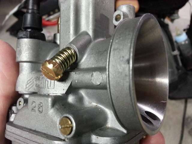

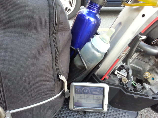

hi forum. Top speed so far. :geekdance:
I have to change out the 24mm oko carb, and put in the 26mm polini carb from scooter swap shop. :geekdance:

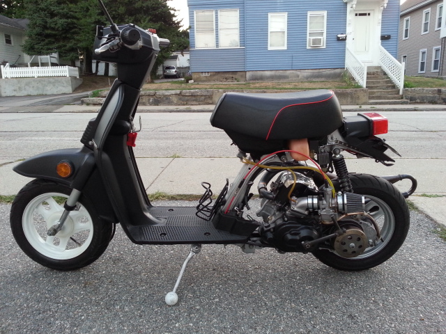

Post by z50 chopper »
:geekdance: pictures :geekdance: :blah: words :blah:
very clear photos and great build by the looks of it.

z50 chopper wrote::geekdance: pictures :geekdance: :blah: words :blah:

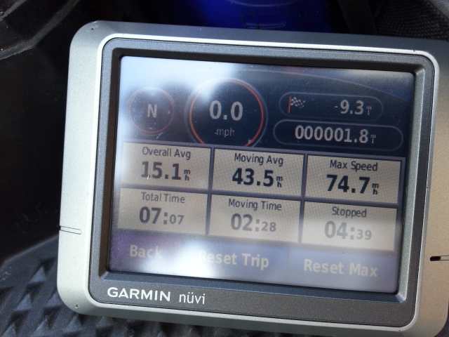

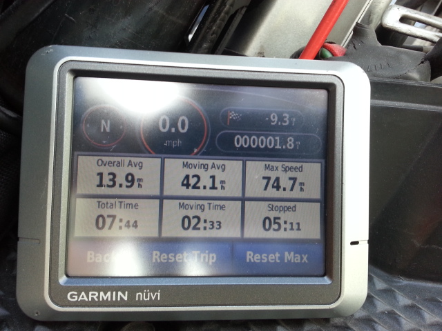

Thanks z50. This is my first Stroker build. it took a while to put it all together, but I'm happy with the results. :smile: here's my top speed so far. :thumbwink:
MrJumps
Posts: 1339
Post by MrJumps »
75mph, can you hokd that for a long while say 20 minute comute?
