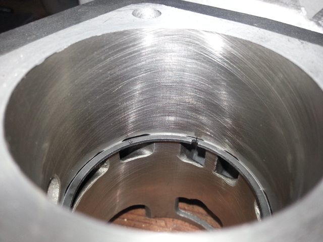

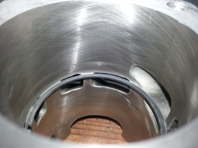

I got to look a little closer at my cylinder today. Im impressed with how well the opening of the transfer ports are all fairly even. I've seen kits that are more than a millimeter off. All transfers should open at the same time. I havent gotten my timing figured out yet, but a good chamfer will even these ports out.

I think I want to cut out the bottom of the lower boost port in the cylinder skirt. I havent seen it closed off like that before, but Ill wait to do a mock up with the new crank installed to see how far down the piston travels.

looks more like just scuff marks from where he moved the ring into place .
