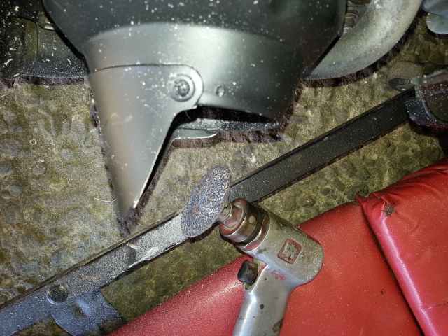

Hi forum. By request. This is what I used to make my air scoop.
A 3'' PVC pipe. cut to fit. and screws.
I also used RTV silicon to plug extra holes.
some flat black paint. :thumbwink:

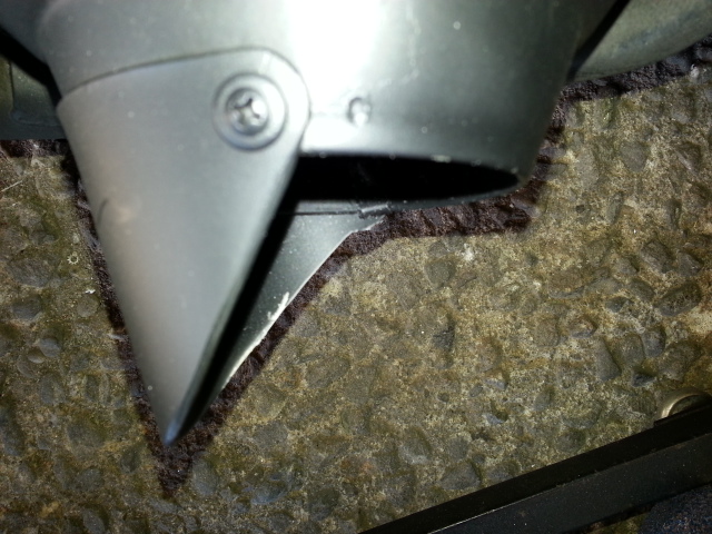

hi make sure your scoop is vertical and even to catch the air. If its off on one side it will become a ramp. And flow the air away from the fan. which is no good.
you can see I have to cut or grind down my new one, on the bottom side to make it even with the top. that way the air flow go's into the fan. and not like a skateboard ramp. that will flow the air out.
