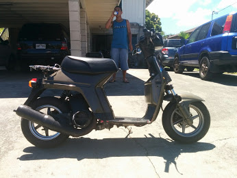

ill upload more pix when i can... what it was then and what it is now she came along way...
- spree.jpg (9.71 KiB) Viewed 12953 times

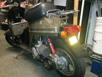

heres some pix i had on my phone
- spree2.jpg (31.63 KiB) Viewed 12951 times
- spree1.jpg (37.35 KiB) Viewed 12951 times

All you need now is the jap round headlight .

Must have that tail!

I wanted to keep the 84 stock look so i kept the headset not a big fan of the smile or eve headset

nice! what taillight is that from?

thanks for the love ...btw its and eve smile taillight assembly

tell us about it. im curious what front fork as well

its an 84 spreeve (spree, eve smile) dio and disked converted.. disk front is a spree stem with DD50 tree welded on top.. legs,caliper and rotor is also from dd50.. 72 corsa non ported, SYM block match ported, 2ab reinforced stock crank, gearing 7:1, 28 Keihin, pg long, lightened mag i forget how much grams it is, drive consists of kelly heavy with polini 2000 clutch, and a daytona 10% center all on ZX trans. Kelly pulley and ramp, GPSd it at 75 with my weight of 220 so not to bad. I know its not as accurate as track time but its ball park figure. body is eve smile back panels fitted with smile tails. all of it rolling on Zx copies

Thanks for all the love believe it or not thats all rattle can, rustoleum 2x light grey primer double coated and wet sanded, dupli color engine enamel Iron, Dupli color engine enamel clear. the color came out because of the primer. all was heat gunned to dry and wet sanded, 2+ coats. My friend can really work with a rattle can no lie.
