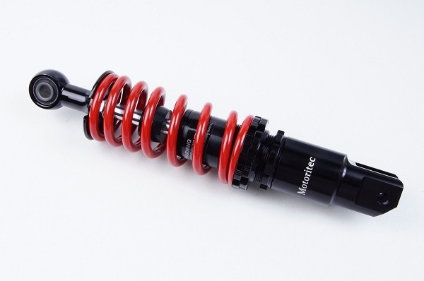

graphite9 wrote:I'm in the process of a good rear shock option.

I can try it out on the 99 later today, I think it may be a little short but hope for the best. The offset would be nice for the 90/90.

Those YSK front shocks I am weary about.. Only 30 bucks?? I wonder how long they will last. I see they measure 8 7/8 in. wich is a common size of rear shock for alot of scooters, so would any 8-7/8 scooter shock fit the bill?
Graphite9, that NCY shock looks good. That seems to be the same style that everyone runs.. Can I fit a 3.5-10 tire on the rear with that shock? Thats my main concern, tire clearance.

That shock has an offset that will allow you to run what ever size you want, the case interference will be the limiting factor. I'm running the low down model on a 01 jog and its a great shock.

I'll order a rear, but not until I know it fits. Need to make sure it'll clear the case and a Metro wheel with a 90/90-10 tire.

A 90/90 tire will easily clear it if that's the size you're worried about. A 10 x 3.5 is a little taller and some may be even too tall and will hit the case under expansion from high speeds. The 90/90 while 1mm wider is shorter.
90/90x10 is 90mm wide and 90% of the width is the height which is 81mm or near. 3.5 x 10 is 89mm wide and 89mm tall.
