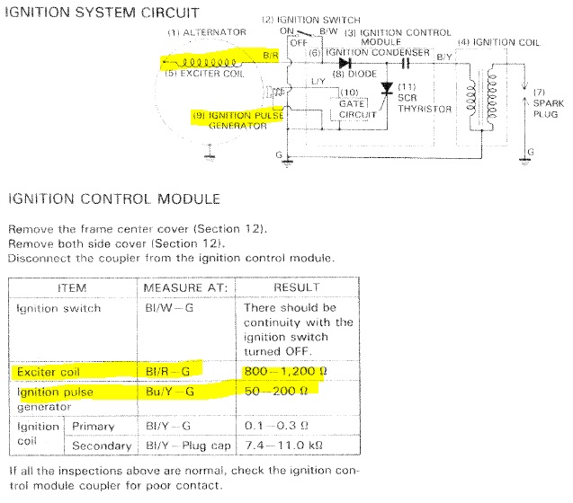

Re: 1987 Honda Elite CH 80 NO SPARK 9K
Can anyone help as to what to check next. Im almost thinking a stator at this point?
Sure, you have the multimeter. Also - check the ignition coil primary and secondary resistances.
-- Stator
There are two tests in the Honda Service Manual for the stator related to ignition function.
1) Exciter Coil - generates high voltage (300+ V) to charge CDI capacitor.
2) Pulse generator coil - triggers discharge of capacitor within the CDI into the ignition coil primary.
Of the two above coils, the pulse generator is the most robust.
-- Ignition coil
