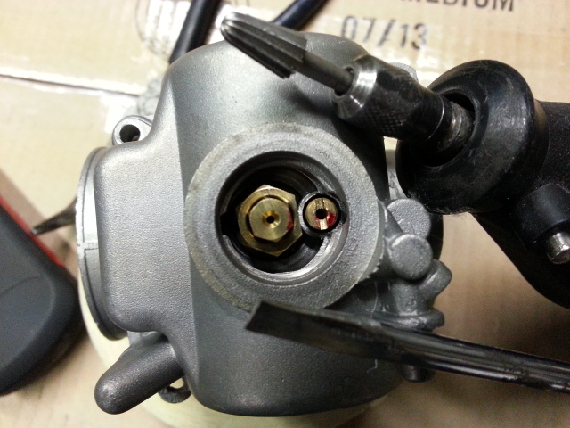

Also does anyone have any pics to dremel out the carb bowl so I can swap the pilot too. thanks

Limp1144 wrote:Also does anyone have any pics to dremel out the carb bowl so I can swap the pilot too. thanks
Hi limp. remove very little at a time until the pilot come out. try not to touch the drain bolt seat. it may leak. take your time. If you drink too much coffee, try at your own risk. :nervous: good luck.
