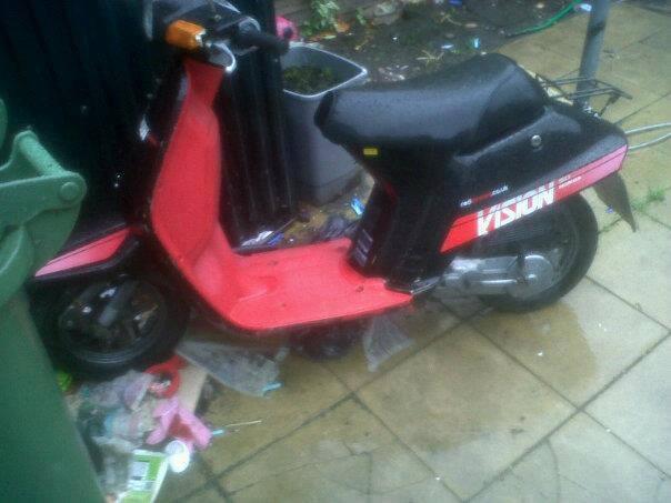

Re: sym dd50 forks onto aero frame?
this is the scooter i want to fit them to.
- 998213_518385588215665_1284775462_n.jpg (34.55 KiB) Viewed 5923 times
with some mods you can fit anything.Will the bolt on and everything fit? No i dont think so
...+1...paulpauly7 wrote:With some mods you can fit anything. Will they bolt on and everything fit? No, I don't think so.
looks like ill be chopping the frame even more then :S
already had to cut up part of the frame to weld in my sr125 mount :S
mating a aprillia sr125 engine to the frame with a 183cc kit and theres no way in * i trust the standard forks and brakes, want to use dd50 forks so looks like im cutting the frame to fit them :S
