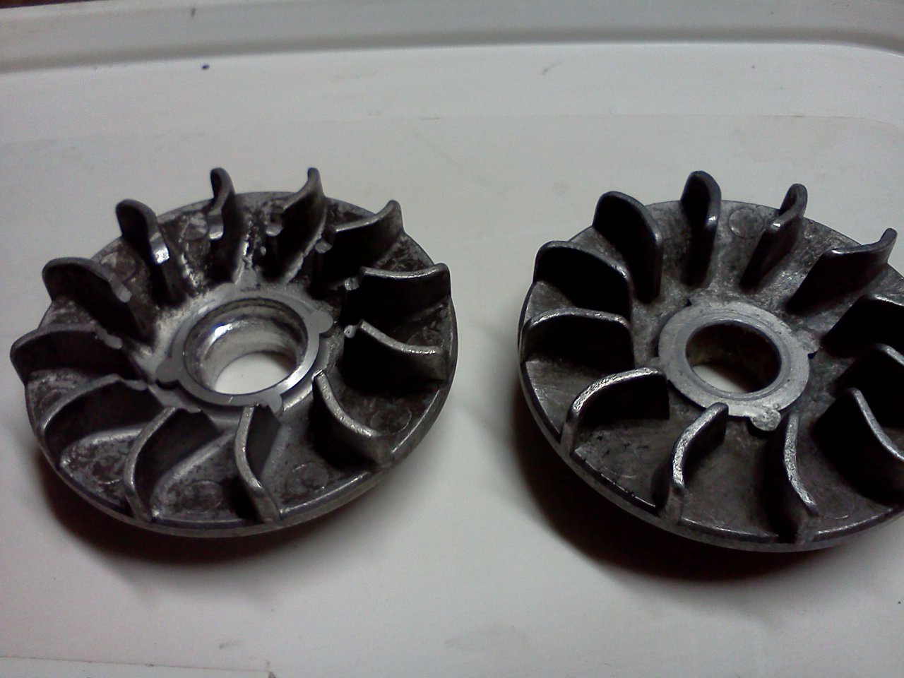

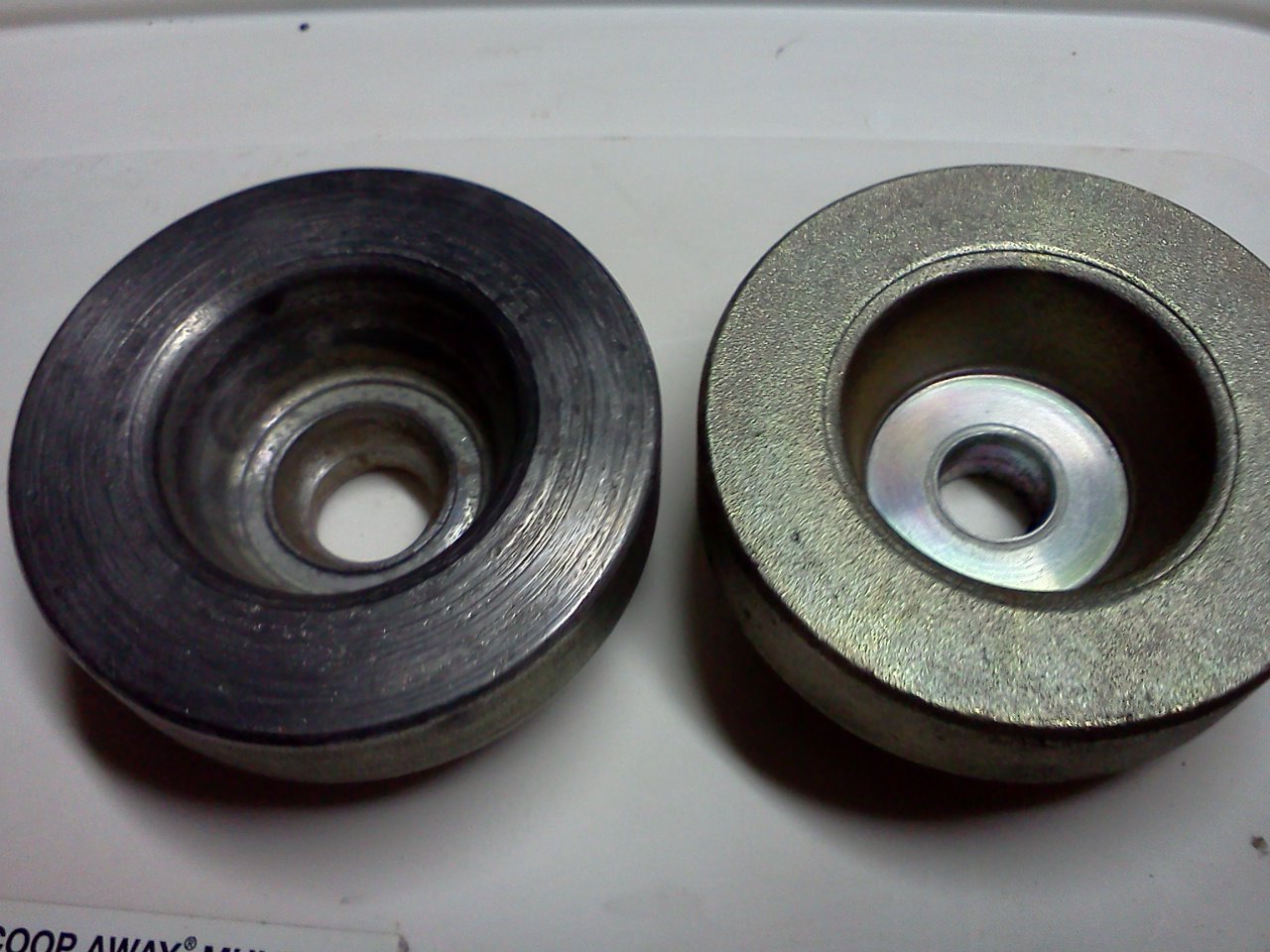

You don't need to measure it, just inspect it. If the shoulder that the thrust washer rides on is no longer flat then it's probably not gonna work. If yours had the non-fin pulley and it wore into it bad enough it started wobbling then your crank has to have similar damage.
This is what it should look like.
If it's rounded off like this one then the thrust washer can't sit flush and pulley will wobble
Bad pulley - Good pulley

Post by spreeinkc »
More bad pulley - good pulley
