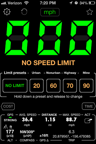

OMG my gps was set at kts not MPH..dumb
85mph was with 6.3 gearing
78mph with 6.8

Hmmmmm that still doesn't explain you're extremely low RPMs though. Can't be going 85 if you're only at 5,500 RPMs.

+1 on that, he also has a Koso speedo he buried past 90 before using the same set up he said.

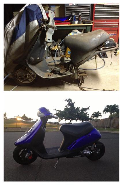

what im working with just incase u guys wonder..before and after.. pic
kandy purple..
LMH
Posts: 1461
Re: best gearing for my strokah..
Post by LMH »
Nice ride. Whats the Koso speedo look like?
