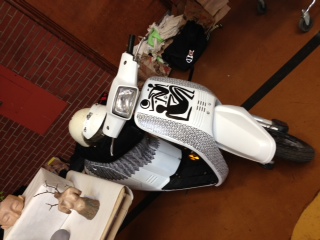

BTW- this is a picture of the bike, actually a kinda cool art project my friend and I worked on.
It's entitled "Lines and Shapes"

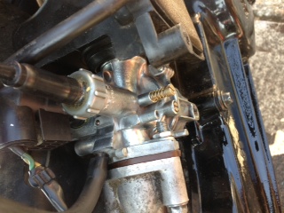

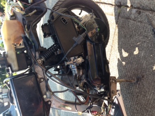

Here are pictures of the carb on the bike, I got fed up and decided to blow off some steam by polishing it.
- photo (14).JPG (45.32 KiB) Viewed 2968 times
- photo (13).JPG (50.9 KiB) Viewed 2968 times
Re: 85' Aero Running Away issue- after 2 chem dipped carbs
Your slide inside the carb where the throttle cable attaches may be sticky.
1. Remove the air filter housing and tube connecting the filter to the carb.
2. Place scooter on center kickstand and start it up.
3. Twist the trottle while it is on there and watch through the carb inlet to see what happens to the slide as you release the trottle.
4. If it stays up and your bike continues to rev you narrowed it down to the slide or cable.
It is possible that your cable is binding somewhere if it is not routed properly and can create a bind even with a working cable. Check for air leaks by spraying brake cleaner around the carb gaskets and other areas that connect. Dont start your scooter on fire, do this out side of your garage. Good luck.
I watched the slide multiple times and concluded it was working properly.
There was also no air leak according to your test.
What next?
So it was still maintaining the high rpm while conducting the test on the stand? how fast does it pull you while driving when you have the throttle stuck? Is iut stuck at 20 mph? 5 mph? Sounds weird.
So it was still maintaining the high rpm while conducting the test on the stand? how fast does it pull you while driving when you have the throttle stuck? Is it stuck at full throttle?
