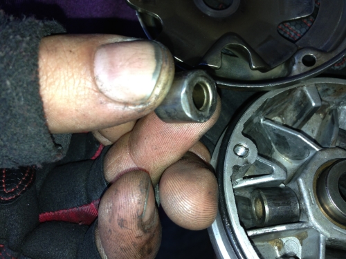

Crackin' away at cleaning today. I got ahead of myself and took apart the starter motor, not sure how to put it back together! wire brush bit to nock the funk and rust off, but still looking funky. Frustrating day! Good news is i have plenty of time to clean the engine until i have enough money to order the parts I need. :?: I don't think I want to fool with a bunch of upgrades right now. I just want to get her on the road, then I can fool around with her guts this winter when I get back from the circus.
Cleaned out the variator. Found a tiny wear spot on this one roller.

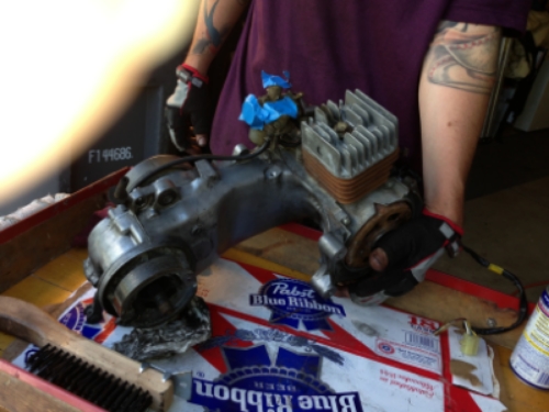

Put a bolt where the spark plug goes while i'm cleaning so i don't damage the plug. taped over some other orifices that i figured should not get dirt in them. I painted the alternator and head vintage rust to give it the classic weathered look.

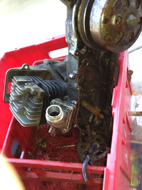

now an old friend just offered me a free 80cc aero engine. do i keep working my aero 50 or rebuild the 80? how much the parts are interchangabole???

devenex wrote:There's an old build thread where someone swapped an Aero 80 motor into an Aero 50 (I think, on second thought it could have been a spree). Either way reading it should give you a good idea of what work would be required.
Yeah man there are quite a few. The 80cc looks like it's in ruff shape, but i'm hoping I can swap some parts over, mainly the crankshaft and possibly the variator/rollers. Thanks again for all your input.

I doubt the cranks are interchangeable. If all you have of the 80cc is what's in the pic then it may be easier and cheaper to keep the 50. Although I've been dreaming about an nb50 with a nh80 swap for a while now. Can't say I've ever seen one...

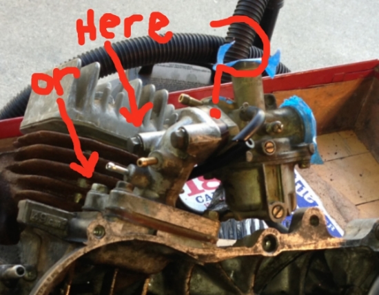

I'm not sure if that's the right part anymore. I posted a WTB ad and mousewheels said i might not even have an 85. so i'm back to stupid where i started... :|
mousewheels said "'85 would have no kick start, but I don't recall they left an open hole there.
Check the intake to crankcase connection. If it's 2 bolt it's an '85." and "1985 had a different p/n crank than 1986-87, and 83/84 Aero's have a different stroke."
Re: To sell, or not to sell my 85 Aero 50, that is the quest
I'm seeing a 4 bolt intake :)
BTW - the head is on 90 degrees from what it should be. Fins should point sideways, not front/back
Edit: Head is ok as is, my own head must have been sideways :lol:
