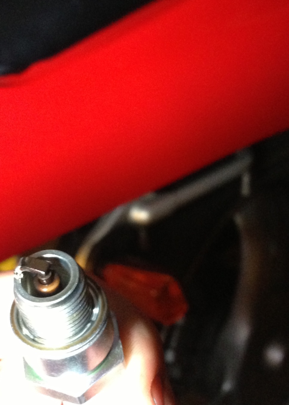

Here's a picture of the spark plug... Doesn't look "lean" to me.

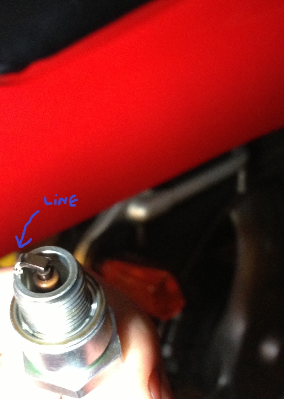

your plug looks coco brown so i think your okay. i know that the position of the color line looks good. not that i really know what that means. i know a plug expert on here will chime in since you took such a nice pic.
uncontrollable revving and a lean conditions are not usually synonymous. take a picture of the position your slide is in, when you put it back in your carb. it only goes in one way.
