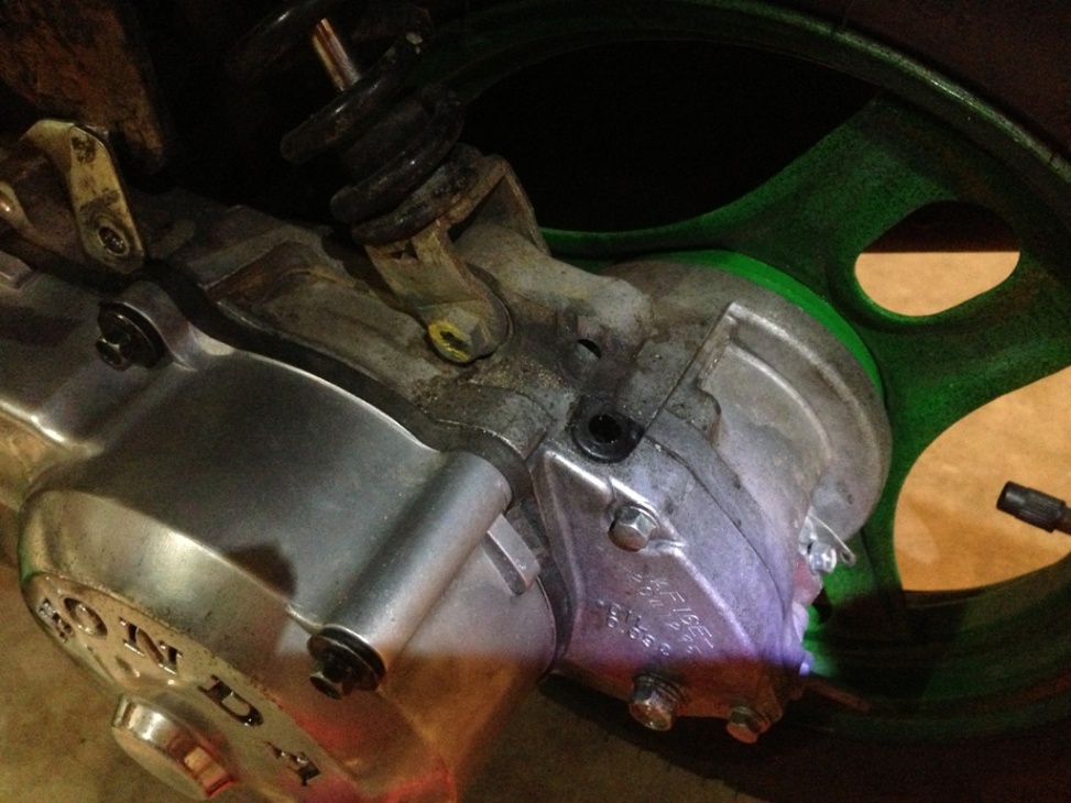

First, on the top of the transmission case there was a black rubber grommet. Looks like this is called the "breather tube" on the transmission schematic. The only problem is that mine is missing the tube so it's just wide open. The part is cheap enough I was thinking about just buying the replacement tube. Or can I just pick a section up from the hardware? It looks like it is supposed to go to the bottom of the air cleaner box.

- Breather Tube Grommet but I'm missing the tube.
- IMG_0049.JPG (221.1 KiB) Viewed 15812 times

Re: My 2000 Elite SA50P quest for 45mph
first ... its a breather tube for the finenell drive it go no were...
