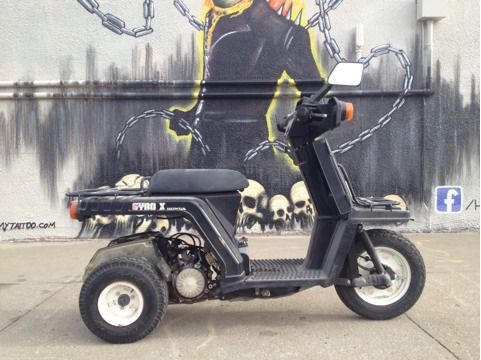

I scored a Honda Gyro X last night. Pretty rare here in the States. CVT, differential rear! It's a bike I've always wanted, so I don't feel too badly for paying more than I would have liked. Does anyone have a manual/schematic for this thinger?
The top end was off when I bought it, and stupid me wasn't careful when moving it and I cracked the piston. Anyone have a cheap stock Elite (DIO?) piston I could try?

Re: Piston - IRC Gyro X has slightly different bore/stroke than AF05 and AF16...
40.0×39.3 Gyro X
41.0 x 37.4 Elite SA50 - 88-93 (AF05)
39.0 x 41.4 Elite SA50 94-up (AF16)

Looks like the bore/stroke is almost dead-on for a Honda Hobbit. I have a spare top end of one of those here that I will try out.

I'm searching around for a link for bore/stroke. Darn internet, changes on you...
The guys here found a source for Malossi bore kits that should fit the "X" --> Click me!

Ok, looks like Gyro X top end is probably the same as the Aero 50. Off to part scour.

Sorry- '83/84 Aero 50 to be precise.
