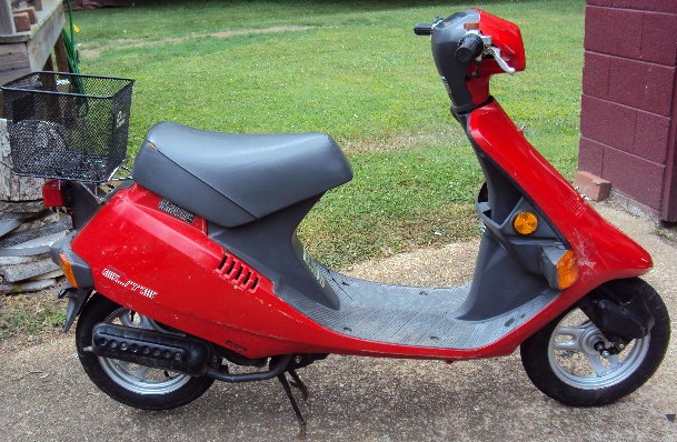

Since I was lucky enough to come across an '87 SE50P, I have gleaned this thread for tips...so "Thanks" to evilone, trafficjamz, Wheelieman, and the rest for helping the scooter world along the path to that never-ending pursuit of 2 more miles per hour.
I will start with:
A. 90/90 on the back
B. maybe a Keli vari
C. 7 gram Dr Pulley sliders
D. a pipe--not sure which kind [recommendations ??]
E. #85 Main jet
F. FULLY OPEN oil pump control with 1 oz. added to tank
Does this look like a good plan of action ? ...

Don't knock it. 2 more MPH is fully 5% faster. The pipes, the pipes are calling, but their buzz is fading fast for AF oh-fives. You may still get lucky and score a LeoVince kit #4447 for the Aero/early Elite engine. See SCooter-Center and the other Euro vendors if nobody here has one they're willing to sell. The Elite has the added advantage over the Aero I had of the pipe not knocking the bodywork going over bumps. Of course, the Holy Grail pipe for this engine is the Wild Lion by Malossi. Good luck finding one, though.
85 main if you keep the airbox - which I recommend for your plans. Easy to get 99101-187-0880 number 88 can be had from Honda if you decide on a pod filter.
