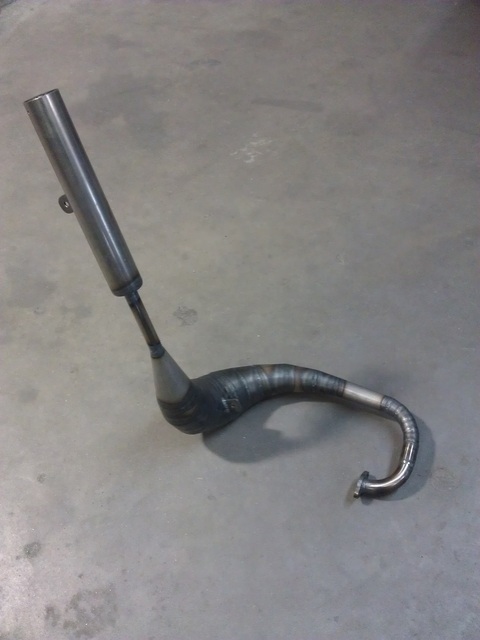

I have chosen someone to test the pipe, thanks for all the emails and great comments! When the silencer comes off the dwell section it's call a side bleed. I use this design for many reasons, the main one being performance. A 2t pipe works largely on sound waves and the reverberation of them. On a standard exit pipe up to 30% of the useful waves exit the pipe as noise. On a side bleed almost 100% of the waves are contained! This helps to "stuff" the cylinder and give a much more pronounced power band than traditional chambers. Side bleed pipes are also significantly quieter and almost never need the packing replaced.

I did some test runs with the new pipe today and WOW this thing is awesome! I literally just bolted the pipe on, no other modifications at all, stock air box and all. Top speed prior to the pipe was 28MPH and now 35MPH! The pipe hits at around 15MPH and rockets the bike up to 35MPH. I know that with a high flow air filter and larger main jet I will easily see 40+MPH!

Above describes about what the pipe I built does. Engine is blah up to 15 MPH then it takes off. Spree has 1 gear... I think that the sweet spot is making power in midrange. With a side exit you can make the pipe longer which will bring down the band. The 25mm downpipe will help alot, esp with the larger piston/jug available aftermarket. Stock is 19mm, which is really too small.Motion Left Mopeds wrote: I am looking forward to making a pipe for the 48mm bore kit for the Spree. I need some info before I make a prototype. Does anyone have a port map, pictures of the head and common modifications made to it? Does the stock Spree pipe bolt right up to it? And what is the desired power band low, mid, or high?
Port timing is listed in the service manual... from memory the exhaust port is 225mm^2. Too small for a 50cc bike, and timing is overly conservative. Lifting the exhaust port timing by a mm or 2 is reported to help.
There are 2 versions of the head and dished and domed pistons. There are pictures on this site of the different head designs. Most common mod to head is to mill .020" off the head to increase compression and create squish. Ditching the dished piston for domed is popular as well.

I get the same gains from the my sample that looks like the first muffler pic you posted. It gains about 6mph on stock and about 5-6mph on the 48mm BBK, carb, and gears. It is a nice add. How much you gonna sell those pipes for? I will sell mine for about 125$ and they will be available this spring. I would love to test that second model you have or are they the same pipe? It looks kewl. Looks like the one I got already.
The muffler I have have is set up for mid to high which I like. Also the noise level is not to bad.

The port map of the big bore kits will decide what chamber I use, but I will likely be using my Cali chamber with a side bleed on it. It's great for single speed motors! The picture is a Cali pipe I make for Puch Magnum mopeds.
