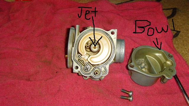

Alright man im going to try and be nice..... the bowl is the name of the part of the carb that u take the screw off and attaches to the carb the only movable part in the bowl is the drain!!
the jet it the thing with the tiny hole and needs to be soaked in carb clean and blasted with compressed air. i take apart the whole carb and soak it in carb clean by the gallon.

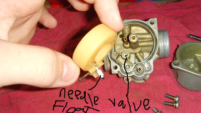

the needle valve is where the gas comes in and is always where my problme is soack the whole carb assembly in carb clean and blast it out with compreesed air. also make sure the float needle isnt scratched.

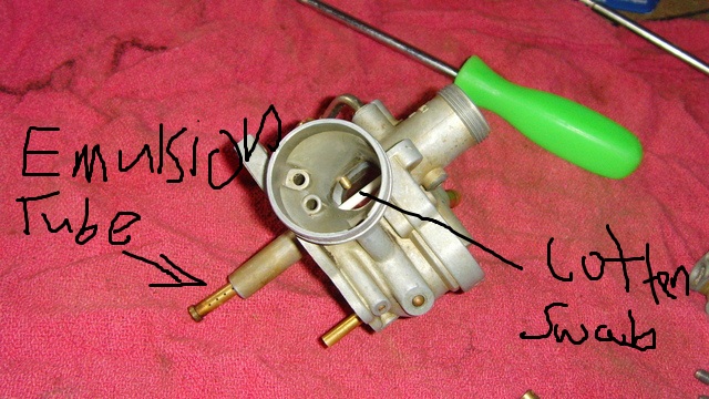

next use a cotton swab to push out the emulsion tube AFTER you take out the JET (only jet...) soack all these parts in carb clean and blow with compressed air

as well as the other pictures have indicated, you HAVE to clean the pilot jet. it gets clogged very easily, and can be quite a pain to clean if fully clogged. best way to clean is with an 11 gauge guitar string or similarly sized piece of stiff wire, spray in cleaner and let soak, poke around in both sides of the jet, blow out with compressed air and repeat untill you can get a pin * of light through it or a steady stream of air or carb cleaner to flow through it.
