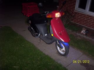

WilliamK
Posts: 55
Joined: Thu Dec 01, 2011 8:30 am
Location: Waterloo, Indiana
Re: Melt down...
Post by WilliamK »
pic of her all together.
night scoot.jpg (11.14 KiB) Viewed 5616 times
