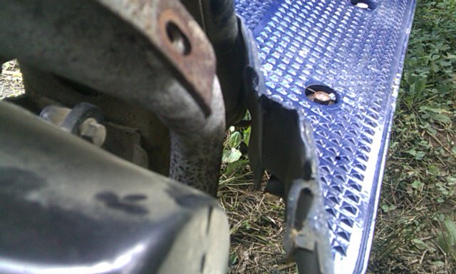

I thought I would up date this a bit, I swapped the float from my elite which is compatible but not the valve from 94-01, the sa50 88-93 is the same not that it helps me any. it seemed to run a tiny bit better but still cut out on the rub board that is my road. sooo while waiting for a valve and float to come in for the spree i decided to do a little experimentation. I have been running without an exhaust gasket so i took an extra one i had for the elite and cut a chunk out of it and bent it back round and staggered the layers so that the cut section would be spaced out evenly so as to prevent any leaks. took her out and she only bogs on deep holes so I am thinking a large enough jar creates a leak around the exhaust at the moment of combustion causing me to lose some compression till I even out. before i had a gasket i couldnt jump up and down now i can without it bogging. ALSO I cross referenced the float valves and the same part number was used in my 83 c70 so I took it out and put that in the spree also, a tiny improvement but still the same. I put the spree valve in the c70 and it runs without a problem. I am willing to bet that at impact the exhaust opens a fraction at the head releasing some of my atomized fuel before it can properly combust. For future reference I have copied a list of most honda models that use the 16155-882-005 float needle, might be good to put in the wiki wheelman
also could the melted plastic in these pictures be a symptom of my exhaust leak?
