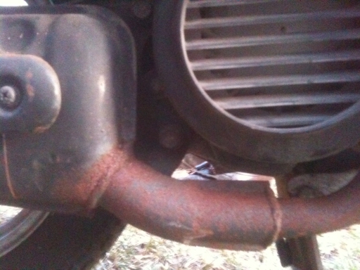

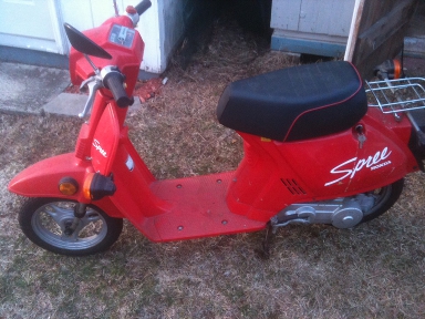

Here are two pics. I didn't realize that it was only a single speed. Around here, I would have to drive on the side of the road (where all the glass usually resides).
Well, I was going to offer $200. I am not sure if it runs or not. I was going to check with the owner to see how long it has been since it was used. Anything else I should check for??

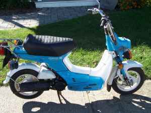

As I am a little concerned over the 25-30 mph speed limit of this model, I found this Honda for just a little bit more money. ($300) It needs a battery and maybe a new rear tire.
It appears to be a 1981 NX50. How does it compare to an 86 Spree? Is it also reliable? Is it faster than a spree? I read it also has a top end of about 30mph.
By the way, when I reference faster, I am not looking for a speed demon. Rather, I am looking for something that MAY be able to do 35+ on flat. This way I will have better chances of riding with traffic.

Re: Looking at an 86 spree for first scooter - suggestions?
That is a cool scooter... can't say I've ever seen one of those.
It comes down to variator or no variator on top speed. Spree and the SB50 don't have variators and are slower. Elites and other bikes do. For the same money, get a variated bike.
That is a Honda Express SR It has the same top speed as a spree, but it will get to that speed much quicker.japennell wrote:As I am a little concerned over the 25-30 mph speed limit of this model, I found this Honda for just a little bit more money. ($300) It needs a battery and maybe a new rear tire.
Thanks!
The spree is a more reliable model
It would be harder to find parts for the SR too.
If 30+mph is the goal.....maybe try to find a 1987 elite 50 or 1994 - 2001 Elite S
I have an 82 Honda express SR. I love it. It has been my most reliable scooter.
