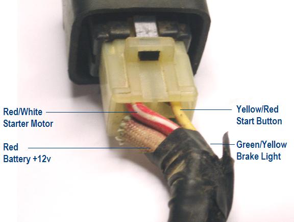

I am figuring some things out as I go, but I need some help with someone who has an aero that has normal wiring. Apparently some amateur electrician had my scoot before me because there are so many hack wires. I really need a pic of what the starter relay is supposed to look like. A pic of it installed would be helpful because I'm pretty sure I don't have a relay at the moment. I think I have my blinkers sorted out. I'll find out tomorrow when I buy a flasher relay instead of the four prong one that was installed(with some horn wires attached) that's why I was betting a buzz instead of a horn.
I cleaned the contacts for the starter button, and checked it with continuity all the way back to where I think the starter relay should be and then it dead ends. So I know the starter button works now. All the bulbs and the blinker switch work, just no lights.

I already have that saved and have been using it. That is what lead me to believe that I don't even have a starter relay. The wire from the starter button just stops. So do all wires that should be connected to a starter relay. The wiring diagram doesn't show where each wire goes to what post on the relay. That is part of the reason I was looking for an actual picture.Bear45-70 wrote:Here is a link to the Service manual. It has a wiring diagram and a lot of pictures of where thing belong. Download it and save it for future reference.

Page 14-10 shows where the wires go on the starter relay and page 1-9 shows where the electrical boxes are located.
I suggest you sit down and make yourself familar with the manual because you keep asking questions that are answered in the manual.

Glad you cleaned the starter contacts, that will keep it trouble free for a good while.
Starter relay connector and wire connections are pretty standard across the Honda scooters we discuss here. Here's a pic of the wires connections at the connector. I think this was a pic of a Spree, - but should map to your Aero. Verify relay coil connections with a multimeter and you'll be good to go.The wiring diagram doesn't show where each wire goes to what post on the relay. That is part of the reason I was looking for an actual picture.
- StarterRelayConnections2.JPG (24.37 KiB) Viewed 5920 times
Re: 85 Aero Electrical Help etc.
I really appreciate the picture. It just confirms what I thought. I have no starter relay. I have that white connector in the picture with the four wires, but it is not connected to anything. I'll try to post pics of what I have to work with tomorrow. I'm hoping I will be able to find a generic one. I looked up the oem one and it's around 30 bucks i think.
