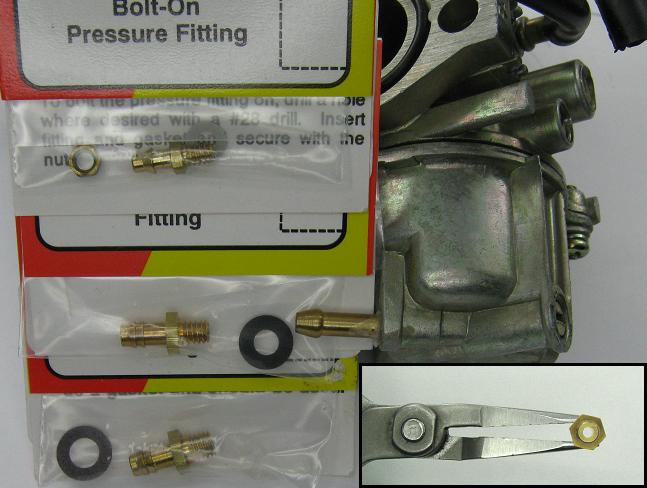

Quick trip to the hobby store landed a set of the DuBro pressure fittings. From top to bottom we have 6-32, 8-32 and 10-32 all priced @ $1.90 ea. Compare the barb to the carb bowl drain (Edit: carb bowl drain barb for size reference), and pick your size. Note on the inset photo, these fittings are just straight through threaded barbs - no check valve.

Back up there :lol: - I mentioned the type of hobby shop (RC models) and put in online link earlier in the thread we are in. In the post you reference, I was trying to help the online shopping guys select the size they wanted. Also to show the fitting is a straight through barb - no internal check valve.

Is the barb 1/8" outer diameter? You don't want any looseness on the vac line - or oil, for that matter.

The outside of the barb portion is closer to 3/16, the smaller tube portion is 1/8
Re: Aftermarket Intake Mani and fuel petcock
Check out the tubing fit. If a bigger one looks better, pm me and I'll mail it out tonight, least we can do after that flywheel puller detour.
